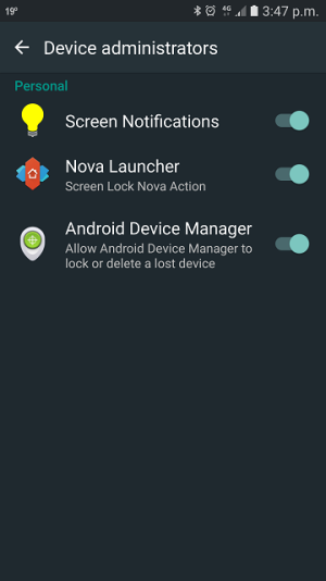

if you have Nova set as an administrator on your phone, that's the cause of the problem.

I have Nova set as device administrator and fps works fine. About the only issue with Nova is if you set a gesture to turn the screen off, and use the gesture to turn the screen off then it will require pin /password. You can have it set in the settings but use the power button to turn off and it should work fine
You can try to disable Nova from device administrator. I don't think it will make a difference, so long as you use the power button to turn off... But you can try.
