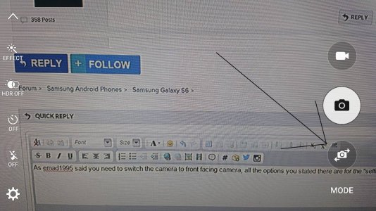

I have no slow motion option on my camera on my Samsung s6
When I click mode only a few options come up.. selfie.wide selfie.interval shot.virtual shot and download. For those of you who say click download. I have already tried there is no slow motion option there either. I have seen other people's s6's when they click mode the slow motion option is there from the start. I'm worried.The slow motion option was one of the main reasons I got the phone . Can anyone help

Re: I have no slow motion option on my camera on my Samsung s6
I think the slow motion only works with the back camera not the front and from the looks of it you are in the front camera modes. Switch to the back and see if you have it.
Posted via galaxy s6
As emad1995 said you need to switch the camera to back facing camera, all the options you stated there are for the front facing camera =).
