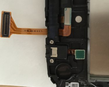

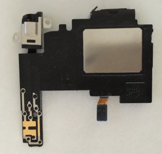

Replace the headphone jack is easy for Galaxy Tab 3 depending of what tablet you have, the 7 and 8 inches tablets only need to remove 2 screws to change it after taking off the rear cover
The 10.1 inches Tab , the jack goes with the left speaker in a whole assembly and you have to remove the mainboard to take it out. Don't try it if you're not confident to disassemble the whole tablet: battery sits on top of mainboard, and mainboard sits on top of the left speaker, there is no short cut to access it.
