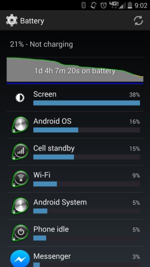

Open up settings / battery usage and take a screenshot (hold power and volume down at the same time until the screenshot happens.) On that page is a graph at the top showing battery left by time. Tap that graph and a new page will open. Grab a screenshot of that and post the screen shots here.
It's likely that you have an app that is keeping the phone awake when it shouldn't and it may be an easy fix.

The cell standby number is high. It does look like the signal was weak at times, but it is possible that switching away from global will help - this will prevent the phone from flopping to the GSM radio when it loses CDMA.
WiFi also looks high. For WiFi, you can go into settings / wifi, tap the menu control bottom right, tap "Advanced", and turn off "scanning always available." You can also try turning on "Wi-Fi optimization" to see if that helps. I leave WiFi always on because if you switch it off with the phone powered off, the phone will use mobile data instead, and that draws more power than WiFi and uses mobile data, which at least for me is capped.
However, 21% battery left after 28 hours is ok if you use the phone a lot. Screen is the highest number - either you are using the phone a lot (though the second graph seems to suggest not) or the brightness is set too high. You can try either turning off auto-brightness and setting the brightness low, or turning auto-brightness on to see if that helps. I've also used an app called Lux to manage autobrightness. As you use the phone you can use the Lux app to set the brightness to what you want if it seems too bright and then set the app to remember that brightness for that level of outside light.

I noticed FB messenger is your top app usage. It could possibly be the battery drain bug many of us were seeing a couple weeks ago. Try uninstalling it and see if that helps.
I thought about that, too, but if you look at the graph where she has no screen on time, which I assume is when she was sleeping and the phone dropped 30%, there is very little awake time in the graph, too. Screen, phone idle, and WiFi are much higher usage in the chart, so I assume that the drain is coming from one of those. Since the screen is off during that time, it's probably WiFi or cellular radio.

Look at the directions I posted above and post those screenshots, best when the battery has been used for a while.
Also, tap the screen setting and post the screen on time...

McAfee. Why do you have that installed?
Screen is very high. What was the screen time for those 2.5 hours?
From the pictures above in the op (second op lol) I noticed you have WiFi on 100% of the time but you aren't connected to any WiFi signal. Has that been the case all day because if so your phone had been wasting battery searching for signals?
Just something I noticed
It is a waste to have WiFi on with no signal, but it isn't a huge drain on battery (unless the OP keeps going in and out of a WiFi range, causing the phone to ping a lot).
