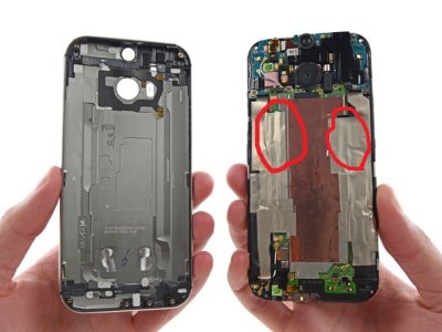

Okay. For 2 weeks I have had this issue. I tried EVERY fix I could find. I clicked Selfie Camera in Snapchat one night and bam, the option was forever gone. I rolled back to Stock Android, tried various roms to no avail. The fix I found, was more simple than I thought.
I had a wave of inspiration. What if, the ribbon cable connected to the daughterboard had jigged loose somehow? So I carefully dismantled my One M8. (If you havent done this before, you may have piles of tape to remove inside). The top 2 ribbon cables were, to my surprise out of the plugs by about 1-2 mm's. So I disconnected them, applied some rubbing alcohol to clean the connections, and repositioned them back in the plugs. Powered back on my phone, and wow. Suddenly my front camera was back! My NFC was back to being reliable, and better yet my audio issues in calls was also fixed.
Previous to the selfie mode issue, I had issues with NFC switching on or off at random, and the mic during calls was mute. I have included a picture to point out which cables to check (Once you peel off the silver tape).
It has worked for me when the first time, I tried this. Then again after 2 days all the options have disappeared again! And as i am following the procedure again and again it is not working anymore :( Any latest or permanent solution?
