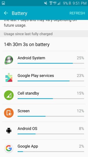

Why is is wifi, standby, android system, and google services draining so much of my S6 Edge battery?
Dec 7, 2015
15

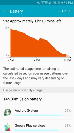

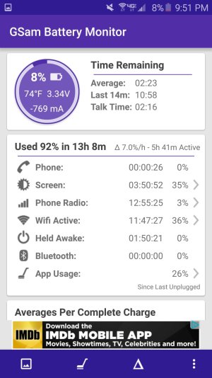

So I got an S6 Edge about 2 months ago, I love it except for the battery. It is not good, but I think there is problem here because of how extreme some things seem. Take a look at the screenshots I have posted below, that doesn't seem normal. Is there a way to fix it that anybody is aware of?

Screen on for 41/2 hours suggests a fair amount of usage so to be expected plus you appear to have Wi-Fi on. If you don't need wi-fil turn it off as it will drain the battery as it will be forever scanning for networks
Wait...your phone's battery usage looks like it actually adds up to the actual percent of battery used. I could be at 40% battery and only show 20-30% battery usage in the apps using the battery. Weird.
In 14.5hrs you used 91% and GSam is showing 7% per hour. I'd say that's actually pretty good. Keep in mind also that those percentages shown are relative to the total amount used, not the total of your battery. Example: If you have 60% of your battery remaining that would mean that 40% has been used. So if it shows that Android System used 25% then it means that it used 25% of the 40% used or 10% (25% of 40%) of your total battery.
