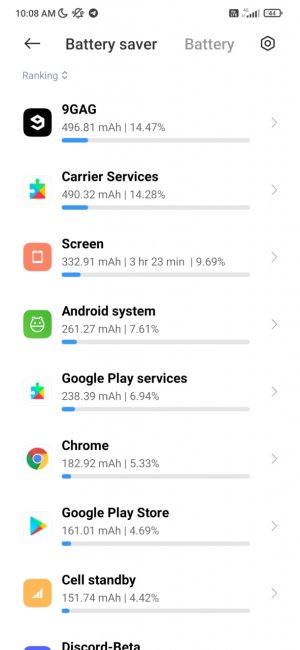

I have only woken up and my battery drained like crazy. Somehow, 9GAG is the one which drained the most, I don't really care about that, I will uninstall it later if needed. The point here is that the Carrier services, Android system, Google Play services, Google Play store and Cell standby have really high usages! I have just done a factory reset yesterday and things have seem to get only worse. I used to have 500-700 mAh usage for the android system and that used to be about it. Right now, just over night, I have something almost twice as consuming! If I were to continue the day without having the need to recharge right now, everything would have been around 2000-3000 mAh just for the "system/needed apps" in order for the device to run. I do not find this thing normal. Can anyone please help me?

Also I'm using a Xiaomi Redmi Note 8 Pro and I've been owning it for one year and a half, or something close to that. It's not about the battery being too old or anything like that because you can see in the photo I just uploaded, it is a software related issue, not hardware.

Welcome to Android Central! I wouldn't call that really high battery usage by those system components. Remember that Google Play Services is an integral part of the system, and is utilized by many different apps, so it's always going to be active. The same obviously goes for Android System. Cell Standby will always use some battery (although the worse your cell signal is, the more battery is used -- how's your cell signal in general?).
Instead of looking at those details, tell us what your overall battery life has been -- i.e., what your screen-on time and standby time has been.
I was going to mention cell signal drain but B. Diddy beat me to that. Just to piggyback on what he said though, the device will work harder to connect to and maintain a signal which I've seen drain some devices in a third to half of the usual life just trying to connect. These things hate being undetectable... not connected to data... not being able to send every piece of data they collect back to all of the data collectors getting rich off of us. Yeah that's the one. lol.
Anyway, SOT will affect battery life too. Being that this all started because you were concerned about your battery life, you're probably turning on the screen more checking your status while not realizing that extra checks equal more battery usage too. So again to what B. Diddy was saying, try using the device normally and see what your actual battery life is, while also not doing any extra checks, because at the end of the day it is less about what is using battery and more about how long you can go without the phone dying or the need to charge, am I right?

The standby time has been quite good but the SoT is just awful. It's around 3-4 and a half hours. Right now, I did a factory reset, and besides that the other apps went back to normal, the Android System still went like 300-400 mAh BUT now the battery life was almost 6 hours with still 25% left! This is the battery life I'm looking for, around 7-8 hours. This is how it's been when I initially bought the device and it's just lovely to not care about the battery for an entire life. I will see again today if it's going to be the same or just go back to 4 hours.. :(. Also there's a weird thing. The android system did not show up as draining the battery in AccuBattery which is kinda weird. I will see again today. I also installed GSam Battery Monitor but I think it's kinda useless because I cannot give it adb permission because I'm not home right now so I don't have access to my PC. Also about the signal, it's been quite good, that shouldn't be the problem since I live in a quite big city. Right now, where it's way worse (I don't even have 4G/internet) it lasted me, just how much I mentioned above.(I was on Wi-Fi 24/7)

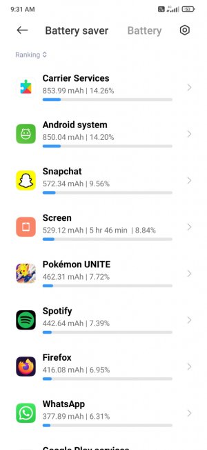

This is what happened overnight. I shall try using safe mode for now. I wanna see if android systems and the others still drain the same amount. It's usually 100 mAh in a few hours.
