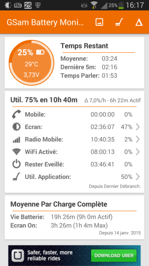

My batteries are EB-L1G6LLU for a Samsung Galaxy S3 4G/LTE (i-9305).

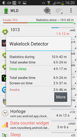

Here are two screenshot I took the other day. I will post some more later today as my battery drains.
I am unsure how to get screenshots from 3 and 4, could you elaborate please?
Thanks you for your help.

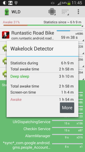

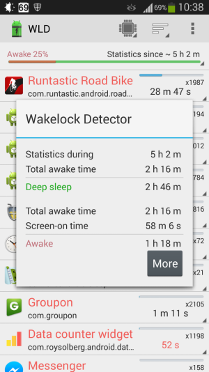

Here is a screenshot of wake lock from battery fully charged to what you can see on it :
I then turned off the Wi-Fi and the screen for one hour :
In one hour : 3% and 2mn awake time.

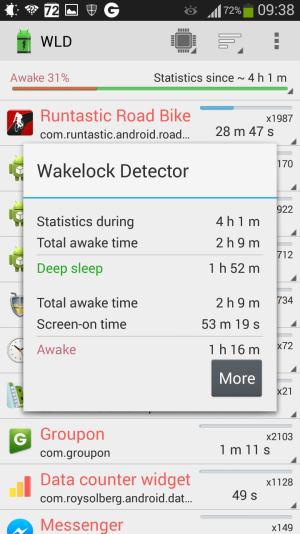

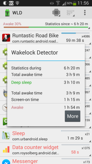

Then I did two more screenshots. First is when I turned the Wi-Fi back on and second is from seconds ago.
As you can see, it drains way more quicker.
I made sure I wasn't recording a runtastic session between two sessions to not skew the datas.

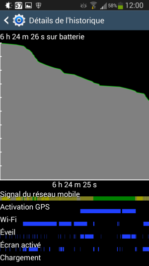

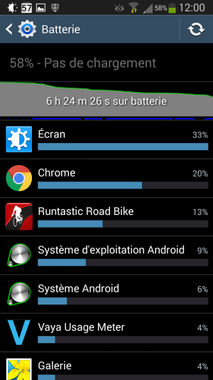

And two of the screenshots you required :Screenshot_2015-01-16-12-00-53.png
I don't have a cell standby entry.
Any idea to find out what's wrong?
Is it the Wi-Fi in itself or an app trying to 'do something' and preventing my phone to go in deep sleep?
If you need anything else, please ask! Thanks

I have to be honest--I don't quite understand those wakelock stats. They don't exactly add up. I can't use those apps, since I'm not rooted, so forgive my ignorance.
From what you describe, it sure sounds like wi-fi is causing issues. How strong is your wi-fi signal? If it's weak, I wonder if that might cause the wi-fi radio to use more battery as it tries to grab the signal--this can happen with weak cell signal, but I'm just not sure about wi-fi. It also could be an app that activates on wi-fi only. Runtastic does seem to be using a fair amount of battery, and is also at the top of the wakelock list. How about an experiment--uninstall Runtastic, and see how the phone does for a day or so.
Re: Battery draining quick - need help figuring this out
I think wake lock displays when your phone was on deepsleep, awake and screen on (the three together = total time since unplugged). The interesting stuff is the awake time I think which is very high when the Wi-Fi is on but not when Wi-Fi is off.
Whatever the strength of the signal, the problem is still there. At home, 2m from the box or when I'm away to catch up a free Wi-Fi.
Runtastic is irrelevant there. I was just happening to use it today but it's not the culprit. It's high in the list because I was doing my biking when I took the screenshot.
So yeah, something is using the Wi-Fi but I don't know how to figure this out...
