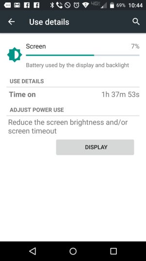

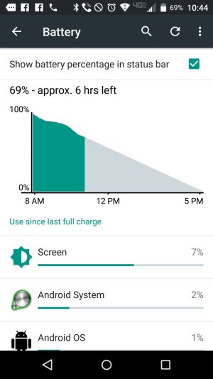

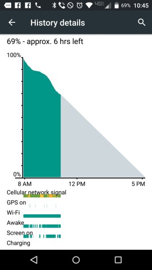

I recently traded in my Droid Turbo (with amazing battery life) for the Droid Turbo 2 after the Verizon rep couldn't get it to turn back on. Sadly, my battery life with the 2 is quite unimpressive.
Is there anyway I can fix this myself or do I have a defective unit? I have attached screenshots.

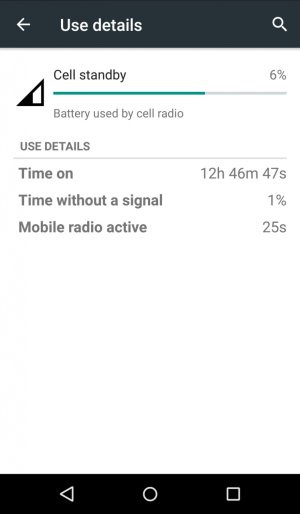

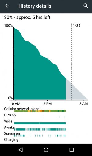

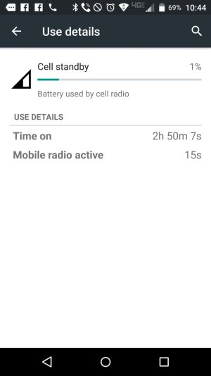

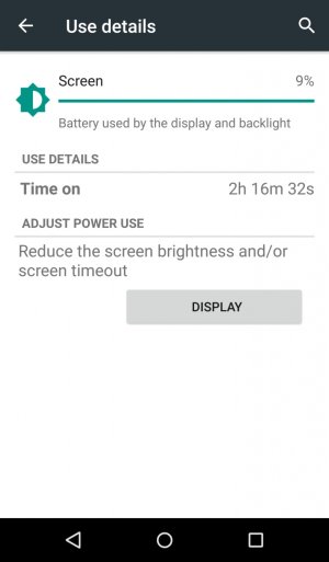

Welcome to Android Central! Charge up to 100%, then let it drain to 20-30% with normal usage, without charging in between. Then show us:
1. The main Settings>Battery screen.
2. The fullscreen battery graph screen (which shows Awake time and Cell Signal Strength).
3. The Screen category (to see total Screen On time).
4. The Cell Standby category, if present (to see Time Without Signal).
http://forums.androidcentral.com/am...ide-how-post-screenshots-android-central.html
I've heard from others that the Turbo 2's battery life is far less impressive than the previous Droids (like the original Turbo and the various Maxx's), so there might not be anything wrong with your particular phone.
Soundtallica
Dec 4, 2015
281
Visit site

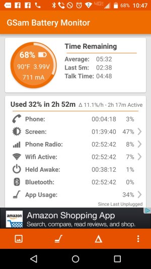

Look at the ratio of your SOT to the time you've had it off the charger. Your screen has been on nearly the entire time except for 8 minutes, so I think this is perfectly normal. It sucks, but the screen on this phone drains the battery like a mofo. I get about an hour, give or take, of SOT every 20% on mine. However, standby battery drain is great so when you put your phone down for a bit your battery life will increase dramatically, and will certainly last more that 5.5 hours. 5.5 hours of SOT is par for the course for this phone.

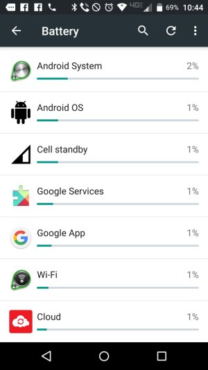

There is a lot of Awake time, which seems to be concentrated during the periods when the screen is actually off. Can you show us the list of battery usage by app? That might give some idea of an app that is misbehaving and keeping the phone awake inappropriately.

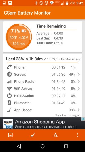

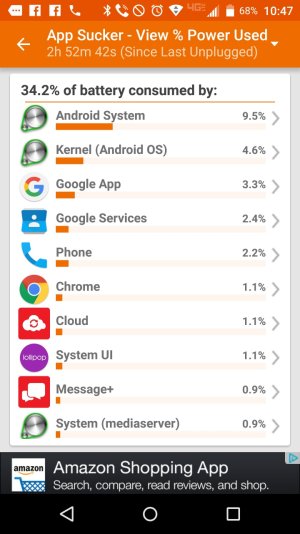

I'd still want to further optimize the phone configuration to reduce unnecessary battery drain, but here's a consideration I'd offer to put this in perspective. I noticed this myself because I was panicking to see similar stats initially. Here's my thought:
I believe that the way these stats and the forecast remaining battery life are reported is being unduly influenced by your usage since you just took the phone offer the charger.
Forgetting GSam for the moment and just looking at the Android approximation of battery use: you've had the phone off-charger for 2h 50m. In that time, you've had the screen on for 1h 38m == 57.6% of the time. If your usage since coming off charger remains consistent for the remaining 6 hours of forecast battery life, this would give you approx another 3.46 hours of screen-on time, for a total forecast screen-on time of approx 5 hours. That's not bad at all, but you can probably do better.
Still seeing a lot of awake time on your phone, and GSAm is showing that 34% of the charge has been consumed by "App Usage" - something to consider and study a bit more closely on your phone.

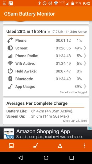

Thank you Jon,
I got nervous because my phone got down to 30% and I didn't have a charger it would not be near my charger anytime soon.
That 34% App usage was due to 9.5% Android System, 4.6% Kernel (Android OS), 3.3% Google App, 2.4% Google Services, 2.2% phone, 1.1% Chrome, Cloud, & System UI, respectively and 8.9% everything else.
Does anything jump out at you?

FWIW, if you are talking on the phone with the display off, it will report the phone as being awake. That is normal.
Unless you are using the Verizon cloud app, I'd suggest disabling it - it seems to be using a lot of your battery.
I agree that the Facebook app is a pain in the neck. I now use the Facebook mobile web site using the phone's browser when I want to look at Facebook.

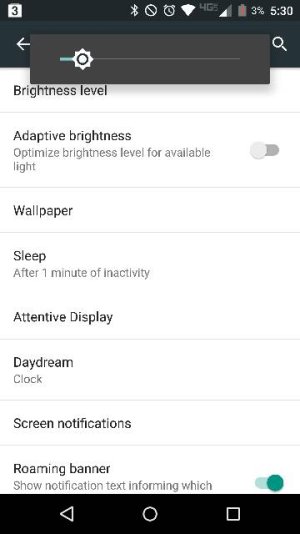

In a lot of your screenshots, the mobile signal is not great. Two of the things that will drain the phone are using the display a lot and having a weak mobile signal - the phone has to increase the power to the antenna in order to hold a signal. That said, GSAM thinks that the radio is only using about 8% of your battery. The real culprit is the display...
Unfortunately, the display on this phone draws a lot of power when it is lit. I'd say that the best way to deal with that is to reduce the brightness to as low as you absolutely need. It's too bad that the Moto decided to go with such a hi-res display. At this size 1080p would have been more than good enough. All those extra pixels don't add much but draw a lot of power to light them up. (It's also too bad that Google insists on preventing a black background if the user wants it - that could help a lot with an AMOLED display.)

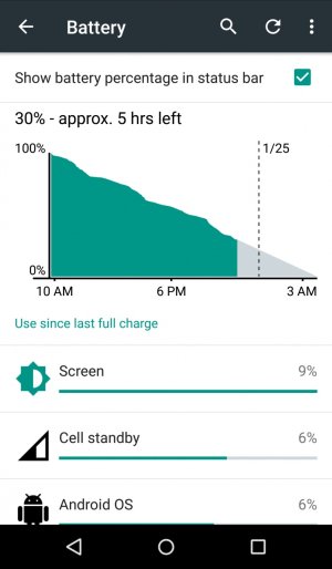

Sorry I disappeared for a few days--been busy at work!
Great input from jonstrong and doogald.:) I'd also add that those last battery stats you gave us showed the battery only down to around 68%, which probably didn't give the best overall picture of what's using your battery. If you don't mind doing it again, charge up to 100%, then use it as you normally would until the battery is down to around 20-30%. Then show us the screenshots.

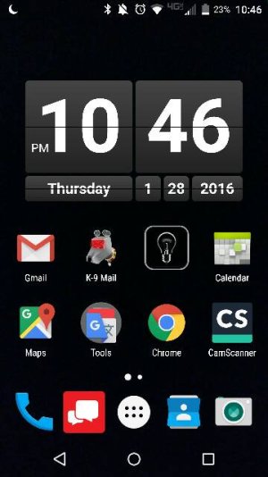

I have figured out a way to have a black background. Sounds simple but it worked for me.
Cover the lens of the Camera and take a picture. Save it and use it as a wall paper
