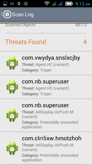

threats: 4
1 : com.vwydya.snslxcjby (trojan)
2: com.nb.superuser (trojan)
3: com.nb.superuser (potentially unwanted app)
4: com.clrrlixw.hmotzhoh (potentially unwanted app)

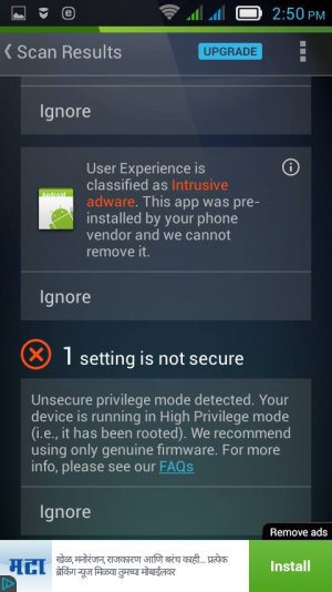

AMBASSADOR, Thanks for your reply, i have disabled auto restore n tried but failed, i didn't rooted my device but ANTI VIRUS says unable to clean malware coz it rooted (seems malware rooted my device) :( :(

The "superuser" stuff is usually referencing a rooted device. Since you didn't root the device yourself, I suspect the virus didn't do so either and is simply trying to fool your anti virus app into thinking it is rooted.
I tried searching for the threats, but Google only turned up this thread. Did the anti virus app give you a virus name associated with the threats? That would be a more common identification and easier to search for solutions.
Along the same lines, which anti virus app are you using?

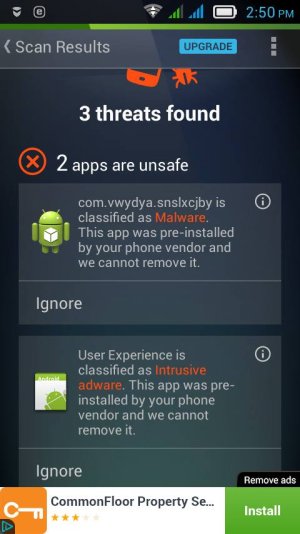

Above threat list is scanned by ESET's Mobile Security & Antivirus.
More or less results shown by CM Security/ 360 Security as wel

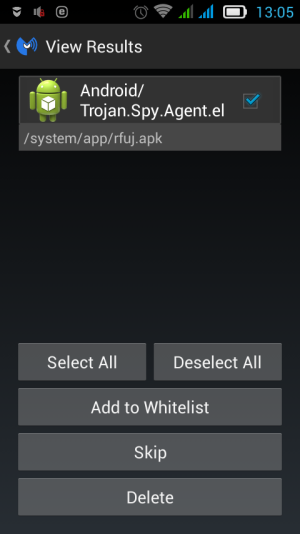

I have used Malwarebytes , it is finding trojan but asking to select it to DELETE , but unable to uninstall here is screen shot for same.

Did you attempt to Delete the apk in Malwarebytes? If not, then have Malwarebytes delete it and then run another full scan with both Malwarebytes and ESET. Uninstall was only if you had the option in the app preferences.
Another thing... Malwarebytes will run in Safe Mode on a PC. I don't know if it'll run in Safe mode on Android. You might try running Malwarebytes in Safe mode if you can't get rid of the trojan while your phone is booted up in normal mode.
Re: factory reset unable to remove malware
nahoku, Thank you very much, 1: I attempted to delete apk in Malwarebyte, says deleteted - then prompting to uninstall App (affected) - Malwarebyte says Deleted. but not deleting threat. 2 : malwarebyte is not available in SAFE MODE
Did you Force stop and Disable the app before having Malwarebytes delete it?

This is weird. I think it might be a good idea to email Eset and see if they can provide any additional info on what their app is finding. I'd also email the device manufacturer to see if those are pre-installed apps. Since they are there after a reset, it's possible they are triggering false positives in the anti-malware apps.
Yeah, they could be false positives and possibly pre-installed Lenovo apps. I did a search on "rfuj.apk" and had no hits. Very weird.
