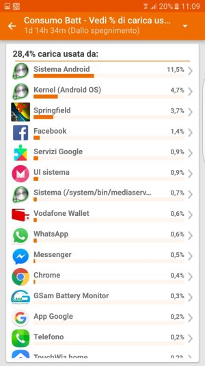

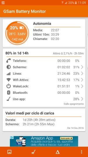

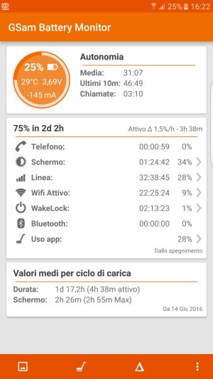

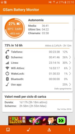

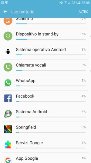

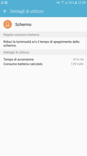

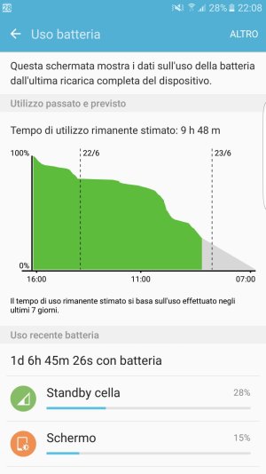

I have the same issue with my italian S6 Edge Plus. If i post some screenshots of the battery stats, can someone help me to understand if have to replace the battery? Thank you :)
Screenshot_20160622-220821.jpg Screenshot_20160622-220836.jpg Screenshot_20160622-220849.jpg Screenshot_20160622-221038.jpg Screenshot_20160622-221047.jpg

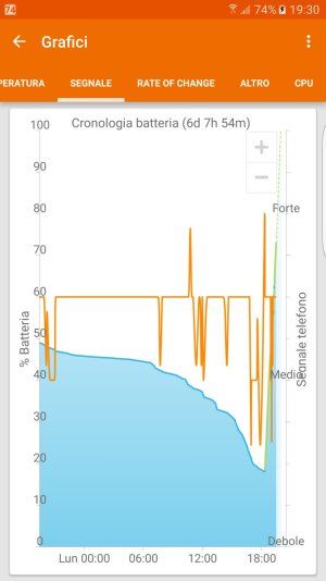

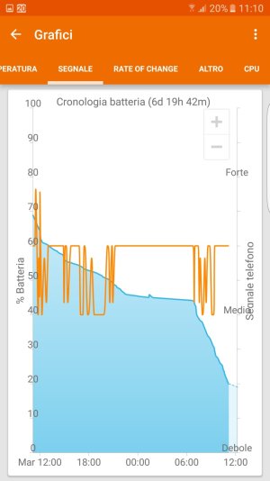

Welcome to Android Central! Your Cell Standby is pretty high, which makes me wonder if your cell signal is generally weak. Show us the GSam graph with the Cell Signal Strength.
Thank you and sorry if i didn't introduced myself! Do i have to wait to discharge the battery until 20-30% to show you the GSam graph with the Cell Signal Strenght?

Yes, it's generally good to see the stats over most of a single battery charge. Gives us a more complete picture of your day.

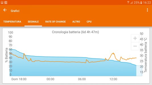

It's hard to comment if the battery didn't drain like it did before. Were you in the same general locations this time, compared to when it drained quickly?
Also, that last screenshot doesn't seem to show the cell signal strength--it seems to be showing the battery temperature (even though I see "segnale" highlighted at the top).
I was in the same locations with this charging cycle. I send another screenshot of the signal. I'm sorry beceause i took it when the battery was charging, but it could be seen the last days stats. Screenshot_20160627-193006.jpg
That's generally pretty good, although there are those later downward spikes. It would be ideal to see that graph the next time you experience battery drain.

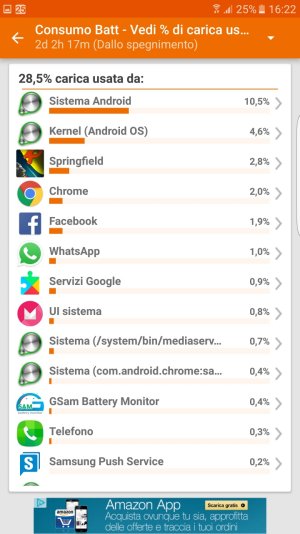

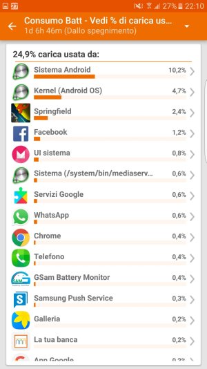

Ok, i will let you know during these days. :) Actually in a 1:30 hour from the last charge i lost 7% of battery and i did't used it. I found the battery of the telephone quite hot (about 28° C) .
That signal doesn't look too bad. I would agree that the battery life isn't great. How old is the phone? Do you regularly let the battery drain to a very low level (i.e., <10%), or let it shut off automatically due to low battery? Doing this regularly can shorten the overall battery lifespan.
I bought the phone in November of the last year. I usually let the battery drain until 20-15%. I thought that my problem could be due to the battery life. I think i will call the assistance to replace it if you think that the battery life isn't good
1 hour of screen-on time with the battery at 20% seems pretty poor--that's on par with or even worse than the Nexus 5, which had notoriously mediocre battery life. And it's not like it's been several days between charges--it looks like this is over the course of 1.5 days. I'll let others with an S6 edge+ weigh in here, but I'd lean towards getting a battery replacement.
As a rule of thumb, start recharging the battery when it hits 30-40%. It's ok to let it go lower every now and then, but the more often you do that, the faster the battery will deteriorate.
Well, i will call the assistance to replace the battery. With the new battery i will charge the phone when it will hits 30-40% and not like a did untill now. I really thank you for the assistance and for the patience that you had to listen my problems. I hope to discuss with you again! :)

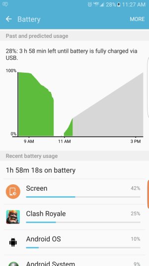

I actually just received my new battery and going to install it but wanted to share my screenshot
