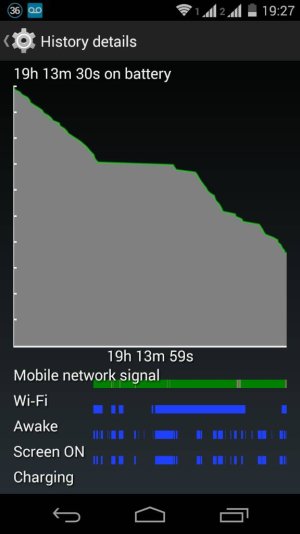

It's been the second time I've had the same problem. Went to bed and left the phone charging with the aeroplane mode on. Woke up, check the time and saw that it was fully charged so unplugged it and went to sleep again. In the morning, after maybe 4~5 hours, the battery was at 71% and still on aeroplane mode. That's a huge drain.
I used the phone normally and after a while I saw that the battery was still at 71%! It took a long time to go down that level and I thought that it could be just a calibration problem. I used the phone for the rest of the day and took an screen shot. Battery life for the day was normal (awesome as usual with this little phone) and nothing strange happened in the next battery charges.
I'm not worried, just curious of what's going on. Most likely it's a calibration problem that fixes on its own. Has anyone seen something like this? Any clue?
The two times that this happened I needed a partial charge the day before (from ~40 to ~70% in the evening). Heavy use after that.
My model is Moto G XT1003 dual sim.

You may be right. The next time you see unexplained battery drain like that, show us the following:
1. The main Settings>Battery screen.
2. The fullscreen battery graph screen (which shows Awake time and Cell Signal Strength).
3. The Screen category (to see total Screen On time).
4. The Cell Standby category, if present (to see Time Without Signal).
If it was overnight and you were on Airplane mode, #3 and #4 should be minimal, but include it just to be complete.
Re: Weird drain on aeroplane mode
I will. But I think it could be misleading. In the screenshot I posted you can see that network, WiFi, awake and screen on are zeroed during the drain. The battery percentages could just be for waking the phone up and taking the screenshot! :)
I know, weird. Reminds me of that battery glitch before 4.4.3. when battery dropped to zero and back to normal after just plugging the phone.
