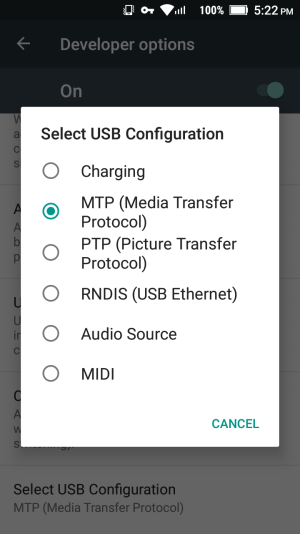

With Android 6.x when you connect for the first time, the option to ignore the connection dialog is automagically checked so if you don't remove it - it never comes up again (whose bright idea, I've no idea).
For example, if you had selected to charge only - the device can -then- never be put into file transfer, right?.. How crazy is that...
Anyway, unless it's something else wrong with your thing, to change USB options:
Developer options > Select USB Configuration
Welcome to Android Central! If that doesn't work, then try different USB cables, since cables can fail without notice.
