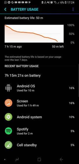

I've had my phone for about 1year and right away I noticed that the battery life isn't as good as my s7 edge was, but now it's worse than it was when I first got it: I'm getting on average 3-4hours screen on time on good days, and overall time off battery is about 8-10 hours.
Others are claiming 19 hours+ still with 4-5 hours screen on time and even that they're complaining about. I went to the Samsung store to check if there's a problem and they just looked at my battery settings and said it's fine due to the fact that screen on time is the highest battery drainer, but I somehow feel as if the battery is damaged. Yesterday I went to the orthodontist and my phone was on 36% when I left my house but I took my battery pack with me, and charged it up to 57% and I had spotify music playing offline in the background for 2 hours- I was out for about 4hrs 30 and my phone went to 11%.

That's quite good if it's 5-6 hours. Today I tested it again and I even put it on power saving mode mode and my battery is nearly dead.
