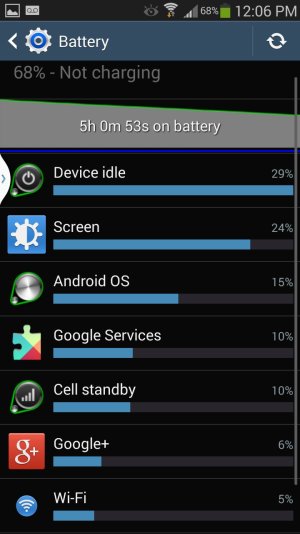

my screen had been on for a total of about 5 minutes at the time of this snap. That would mean that of the 32% of battery that has been used up, about 8% of the battery life has been used by the screen which was only used for about five minutes. Using these numbers, the phone at 100% charge would die in less than an hour if the screen were on and absolutely nothing else was running. Previously, that was not the case. Thanks
OK. Download the app "Wakelock detector." That should tell you what's keeping the phone awake and causing the drain

Battery is still draining pretty fast. I think this may be a battery issue, considering the stats on the screen shot i posted. I will try replacing the battery. Please let me know of any other suggestions if anyone has any.
