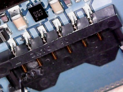

If everything is fine, the only possible cause of this problem is cracked battery connector. Re solder will fix it, and it takes only under 5 minutes
This is a common problem in Samsung tablets: cracked battery connector.
