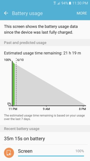

I NEED HELP ASAP. So after unplugging my Samsung Galaxy J7 Prime the screen usage is at 100% then after using it for about 10 minutes and using it again the screen usage is at 60-90% and it never goes down at 50% I have my brighness and screen timeout set to the lowest so why is it like this? This is my 5th time factory data resetting my phone and it's still like this I really need help.
Welcome to the forums. What are you using to check the battery stats, the option in your general settings or any third party app? Can you post a screenshot with those stats? Maybe there's nothing wrong with those numbers if they reflect relative percentages.
Yes I am checking the stats on the settings and I am not using any third party app I already have a screenshot but I do not know how I can post it here I am using the Android Central app.

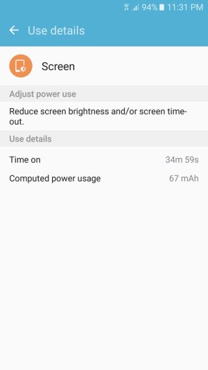

There I have found the way to post the screenshot here, I hope you can help me.
Also I didn't use my phone for about 9 hours because I was sleeping and I saw the screen usage at 40% I was kinda happy but after using it for some time it's already at 63% and does not stop going up unless I don't use it, The other stuffs like Cell standby and Android OS doesn't consume much not like the screen, How do I fix this?
I'm not sure if there's anything wrong with your battery stats. In normal circumstances the screen will be the biggest consumer and in most cases for a wide margin. This is perfectly normal and nothing to worry about.
In my experience the only situations where other processes consume more battery than the screen are when I run heavy background processes (streaming music for hours using a Bluetooth device, for example) and/or my signal is pretty bad.
How is your battery life? According to the estimates on your screenshot it seems fine. Try this. Use your phone normally for a day and post a screenshot here when your battery reaches 30-40%.
If you have the screen on when you unplug the charger, the screen may not be using 100% of the power being consumed, but it's probably using more than 99%. (The percentage is of the total power that's been used since the last charge, not the percentage of total battery power.)
Hours later, the screen will have been responsible for a certain amount of usage, even if it's been off for 9 hours. It's not a "used in the last minute" measure, or "being used at the moment", it's "percentage of the total power consumed since the last charge". As time goes on the screen percentage will go down, but even if you fully charge the phone, use it for an hour, then let it sit with a dark screen for 24 hours, the screen will still have contributed part of the battery usage since the last charge.
The only way to reset that is to recharge the battery, and you shouldn't need to do that until it gets down to 40%. (Don't let it drop too low either - that's not good for it. If you install GSam Battery Monitor and set the alarms to 80% for high and 40% for low, you'll know when to charge it and when to unplug the charger.)
And while you're using the phone since, as Javier said, the screen is one of the largest consumer of battery, it should keep going up. It uses more power per minute than just about anything else in the phone, so its percentage of power used will keep going up.
