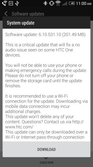

My phone just popped up with a 180MB system update version 6.07.1540.2 that only lists system enhancement in the description. Here's hoping this fixes is.

I've had the same problem with my HTC One M8 for the past couple of weeks! I forced a system update manually and it seems to have worked. I did notice it said something about important bug fixes, we'll see!
This issue popped up on my T-Mobile HTC One (M7) about two weeks ago and has persisted through lots of tweaking and a factory reset. Finally today I manually checked for software updates and I got this: a619f3.jpg
