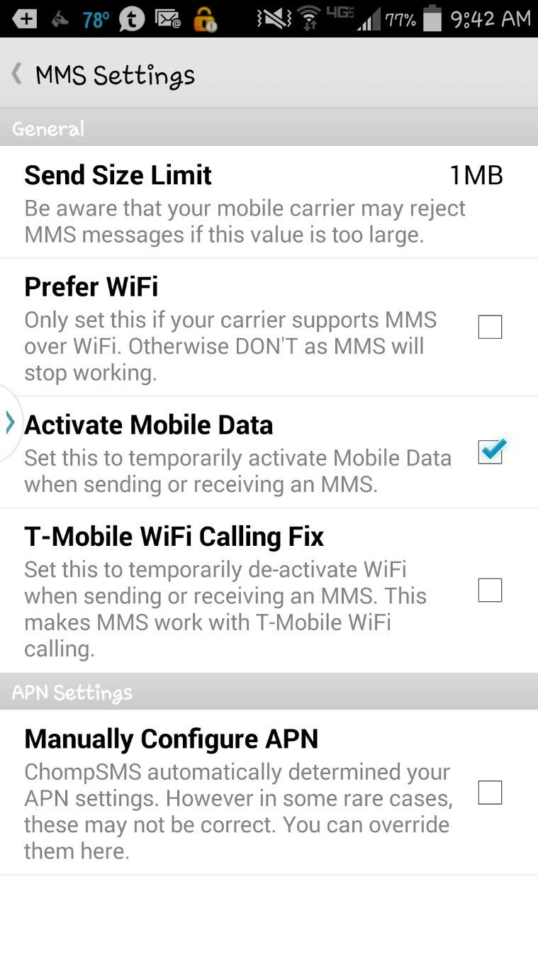

I use Chomp sms just for this exact reason. Verizon doesn't allow MMS over wifi and with a"limited" data plan, I don't leave 4g data running continuously. With Chomp sms, in their settings for MMS, there is an option that you enable it to turn 4g data on automatically just for those few seconds to "send and receive MMS" and then it turns your 4g data back off with you not having to toggle anything. This is a big plus when people send me MMS because the app downloads everything automatically. Textra is a scaled down version of Chomp sms from same devs and does the same thing.
https://forums.androidcentral.com/e...pps/details?id=com.p1.chompsms&token=Y-ogWIa4
http://img.tapatalk.com/d/14/08/31/e6agyha3.jpg
