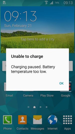

hello guys, please help me with my galaxy s5. the problem is it won't charge and it keep on saying "battery temperature too high or low. i tried to change the battery but the same problem exist. any suggestion or help please. thank you and God bless.

i tried everything. factory reset, changing my charger, changing battery as i said before, opening in safe mode, changing firmware, but all of these didn't solve the problem.
about the Title im so sorry im in a hurry, sounds like weird but its true. i just badly need my phone to get on charging.
Well, judging from what you're saying, it must be a hardware problem... either charging module or motherboard. Searches indicate it's not an unusual problem, and fixes range from reseating the charging module flex cable to replacing the charge module itself. Not sure what direction you want to take... send it in for repair, or brave it and do it yourself. Parts are available on-line... one guy said a board on ebay cost $7 and fixed his problem.`
much appreciated brother. thanks for your help. do you think its a mother board problem or the module flex cable? because there are many sensors that are not working. the barometer and also gyroscope isn't working.
