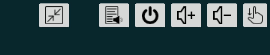

Ok is this the same as this irritating floating menu? I can't get this to go away either and it floats at top of screen on Nougat just under notification bar and gets in the way.
It is a gray icon with two arrows inside a box pointing towards two corners. When you toggle it, more buttons appear:
Read screen out loud (i.e. what screen is showing)
Power button
Volume up and down
And a push to scroll down button
