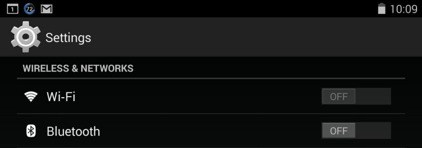

It happened again this morning, but I noticed that not only is Wi-Fi unable to turn on, but the "switch" itself is darker than the Bluetooth switch, which does work as opposed to not even moving for Wi-Fi:
It appears Battery Widget Reborn's Auto Nightmode may be the culprit because since disabling it, the problem hasn't happened again.
