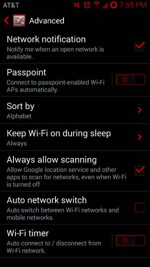

OK setting wifi menu button advanced wifi unchecked auto connect and always scan
Also turn off pass point that's how the att app gets started
Sent from my SAMSUNG-SGH-I337 using AC Forums mobile app
Might help
