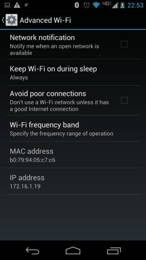

I was having problems too. Open settings then Wi-Fi, then hit the little three dot key, then advanced and turn off 'avoid poor connections.'
My Wi-Fi no longer drops.

I wasnt even able to connect to my Netgear WiFi router until I unchecked this setting. I almost went back to my Thunderbolt, thanks Steve.

Make sure the poor connections is unchecked in Wi-Fi advanced settings. See below for a screenshot
