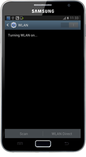

Who can help me , what is the problem with this phone , WIFI couldn't open , I tried update , tried restart... help !!!
Turn off bluetooth and see if the wifi issues gets solved.. this worked for me. .
