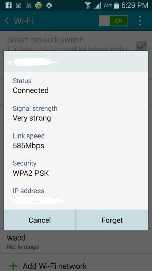

What would be considered a good "Link Speed"? My signal is strong. My link speed, right now, is 13. Is that number directly related to my browsing and download speeds? Under Setting- Connection- Wifi, tap on your wifi connection. What is your link speed? Now mine is 72.

I am in the office with my tablet, 2 feet away from the router. Signal strength is "very good" and my link speed is 72Mbps. Is the router my "access point? My computer is also routed thru the router. Internet service is Hughesnet satellite. Currently my download speed, tested with testmy.net, is 9.1Mbps. Not sure where to find my "link" speed on the desktop (if it has one). There are so many times I'm dead in the water trying to get my tablet to pull up a website but my desktop will open the same url in a jiffy and sometimes they're basically the same in speed of opening pages. I have a Linksys E2000 and wondering if I need a new router.

edit: I have both my Galaxy S5 and my Note 10.1 in front of me about 2 feet from the router that is now at 5GHz. My S5 (is in Wifi mode) and reports a link speed of 144Mbps. Don't know what it was prior to making the change from 2.4 to 5GHz. My tablet is going from 52Mbps to 72Mbps. I've seen it as low as 13.Restarted the devices after the change...no difference. So what has changing the frequency do?

The link speed is the data transfer rate between WiFi connected devices and the WiFi router (hot spot) itself. As B. Diddy points out, this is not the same as your internet speed. However, if you have a really slow internet connection, having a fast WiFi router can help when devices on your WiFi network talk to each other (like sending data to a printer, for example).
Switching to a different band on the WiFi router can result in problems if, for example, you have other devices in your area (your home or perhaps your neighbor's home) which use the same band and interfere with your use (or you interfere with their use). I've seen interference from devices such as wireless phone handsets, wireless audio repeaters, etc. Also, it does no good to switch to the 5GHz band if your WiFi device doesn't use this band.
The bottom line is that if you switch to the 5GHz band and are happy with the performance you get, you should stick with it. However, there may be other considerations. You can do a Google search on the differences between 2.4GHz and 5GHz WiFi router bands and see what you get.
