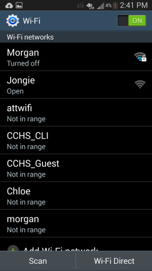

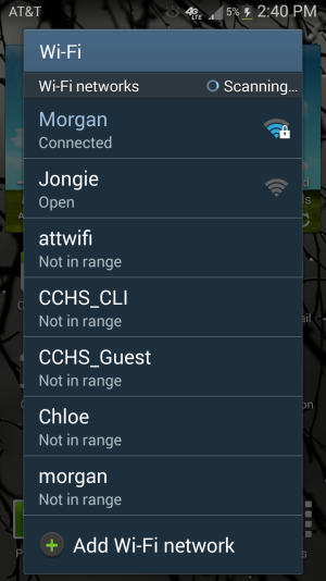

I have a Galaxy S4. My wifi was working fine before and I upgraded to 4.3 software over wifi. I want to do the next software upgrade but my phone won't let me do this without wifi, and ever since the upgrade to 4.3, my wifi won't work. When I turn on the wifi, it shows the list of networks available, and the ones I know are working (my personal one, the one at work) show they have a signal but they say "turned off" underneath the network name. I know they are not turned off. The phone still gives me the option to connect to these networks that say "turned off" and it does say connected, but it never really connects. I am still on 4G. Any suggestions?
