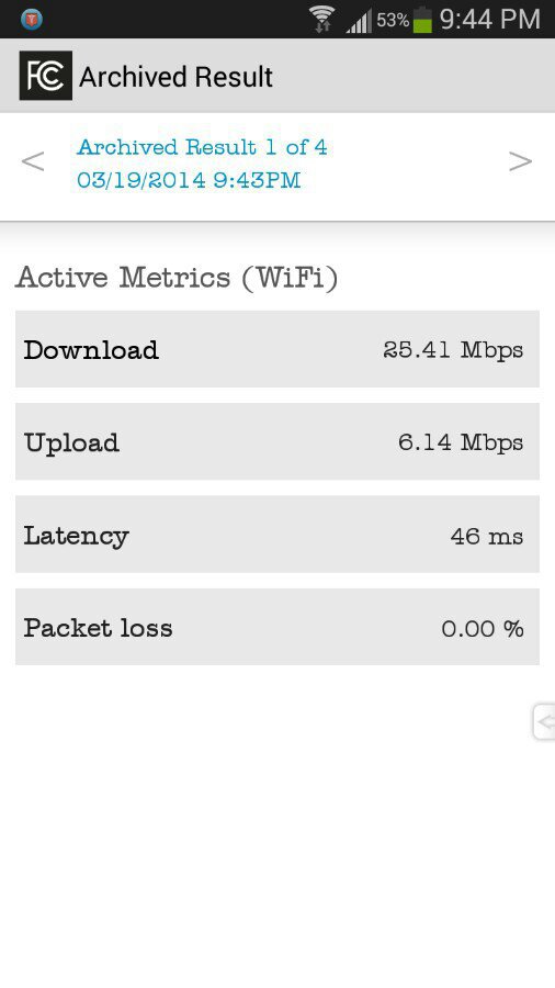

Consistency in a measurement app would be helpful too - I use FCC Speed Test http://market.android.com/details?id=com.samknows.fcc and get

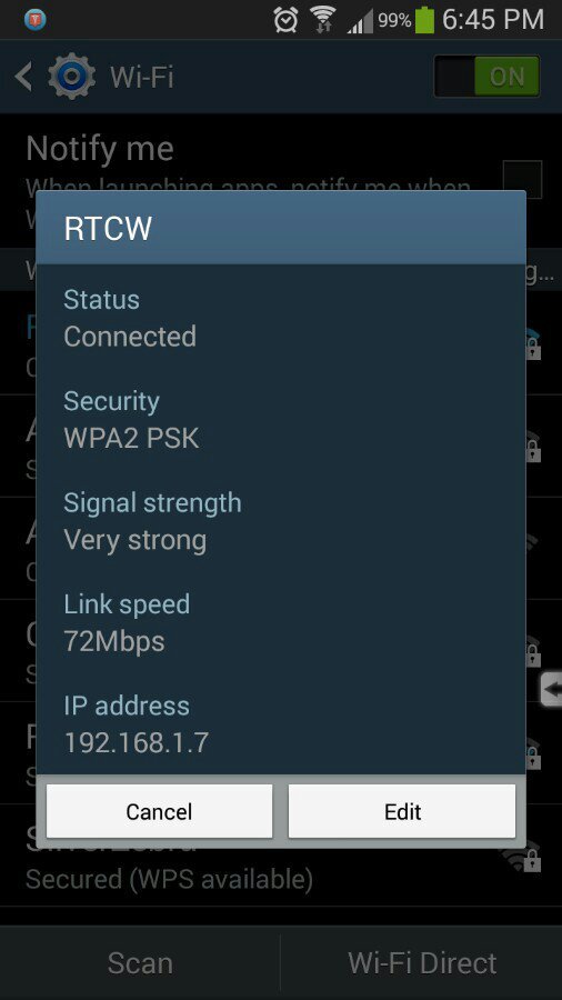

You need to go somewhere that has free Wi-Fi (McDonald's, Starbucks, local library, etc) and get connected and observe the link speed - this will help identify whether the problem is on your phone or router. As shown in the screenshot my link speed is pretty much always at 72Mbps.
