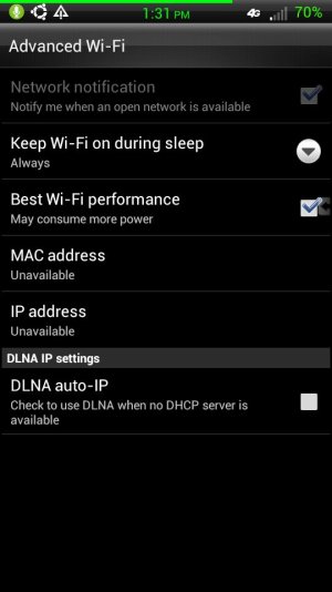

What about this? Do you have the Wi-Fi performance unchecked? uploadfromtaptalk1363897937585.jpg

Best performance was not selected... it is now.
I had the Qualcomm app installed for a little but it's been gone at least a month now. I'll see if best performance makes a difference...

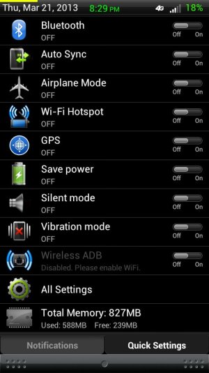

I thought you were modded, here's what I'm talking about. Dizzy...

Aah ok, no don't have that option. It switched off overnight again.
