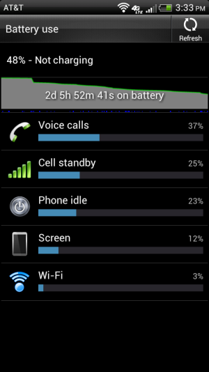

Alright, can you post screen shots?
Here's my current battery screen shot...I last charged Sunday morning. I'm not a very heavy user...I did make a phone call yesterday afternoon and have done some surfing in between. My battery life seems to be slightly better...hard to tell just yet.
Kurt
Sorry, I thought you were on a Nexus 7. I really don't know what to do in your case.
