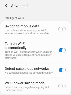

Are you using WPA+WPA2 PSK ? - you probably want to
Connections - Wi-Fi - click on 3 dots for Advanced and turn off all the setting
Also try with wifi back on while you have Airplane mode on.
