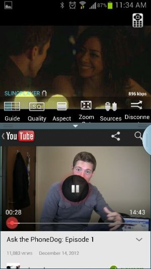

I got one even better, here's a shot running slingplayer and YouTube at the same time on one screen.
Sent from my SAMSUNG-SGH-I317
