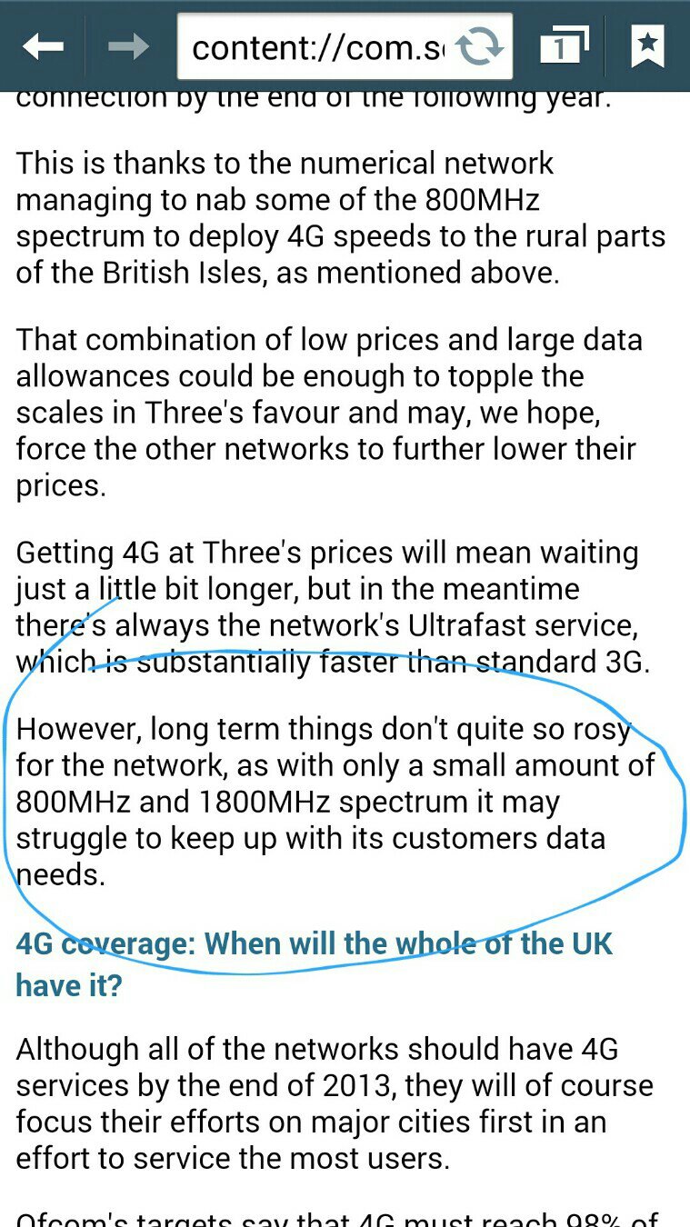

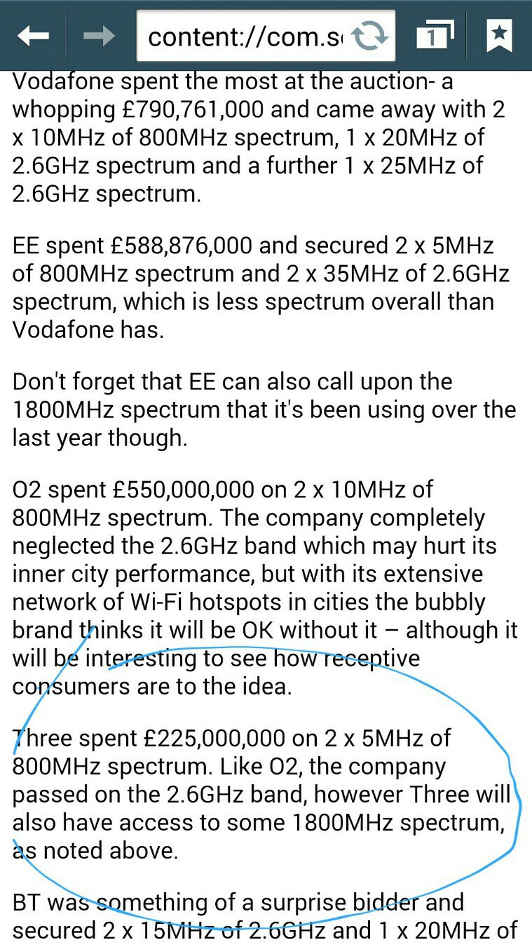

Excerpts from a December TechRadar article from the link above. (I don't know how to find an AC article) - - - -
ADDED: reading it again they may make use of 800 more than 1800.
Sent from my SM-N9005 using Tapatalk Pro

As the OP lived in London I assumed he would be mostly covered by the 1800 band. Three bought some 800 spectrum on a government auction, and they had bought some 1800 off EE previously but couldn't use it for a year.
Vodafone and EE also use the 2600 band.
Vodafone paid £690 million in 2012 I think, closely followed by EE and O2 (800 only).
Three paid least but for a smaller amount of the 800 band.
A lot of dough to make up.
http://m.techradar.com/news/phone-a...4g-and-lte-everything-you-need-to-know-926835
