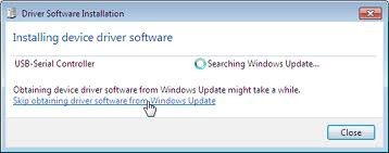

Thanks for this post. It helped me find my way also. My situation was a little different, and so was the solution. I have a Samsung Note 3, which I had to flash with stock firmware after I messed it up:-) When I connected my phone to the pc, I would get the prompt "connected as media", and was able to connect to it with Kies. But I was not able to get an adb connection. I also did not get the prompt on the phone to authorize the debug session to my pc. ( The same message you have in the pic above ) I did not get that. So I kept deleting the drivers from device manager, but the darn things kept coming up, and every time I connected my phone I was in the same situation. The very last time, I decided to click on the message you get on the far right hand side at the bottom about not being able to install the driver successfully, and that gave me this windowsolution.jpg. I then clicked on "skip downloading from windows update link", and as soon as I did that voila; it worked. I saw the above prompt on my phone, and saw the phone id in the output of adb devices. Thank you so much. I sincerely hope my post helps someone else. This was annoying issue.
