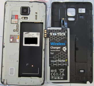

Here you go. This is what you have to work with. The back is plastic, hole would not be an issue.

Yes, you can drill up to a 1 inch hole, 1/4 inch deep. You'll get better results drilling through the screen though.
Rukbat,
Thanks, that helps a great deal. Looking on the web i only saw photos of the self charging back. Perfect.
Chuck Young,
Thanks for the photos!!!! that helps. Thanks for taking the time to post them.

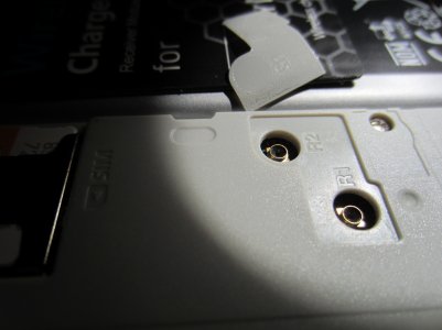

Sadly, i do not see the familiar black stickers covering the miniRF antenna ports I saw on the s2, 3 and 4. Bummer.

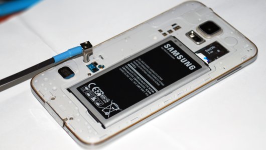

on second thought,
based on this photo,
from here
www telcoantennas com au/site/patch-lead-samsung-galaxy-s5
it might be in that gray patch above the speaker (?).
