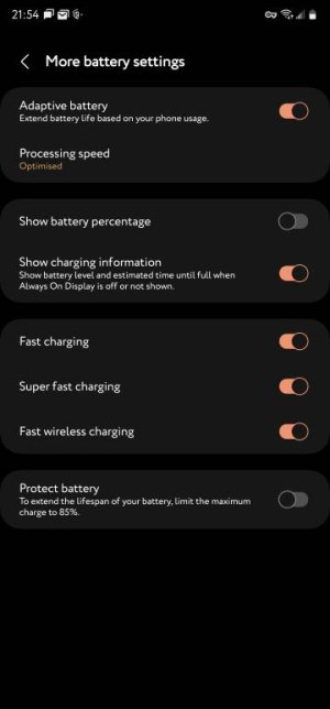

Have you enabled protect battery?

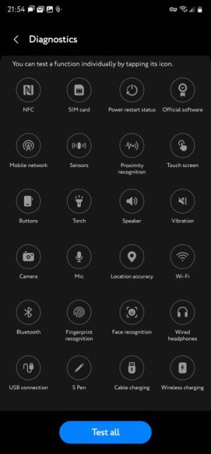

Have you tried diagnostic to check wireless charging?
Screenshot_20221118_215421_Device care.jpgScreenshot_20221118_215457_Samsung Members.jpg
