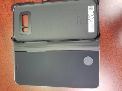

Mine works but I have not used the Samsung brick. I used third party QC 2.0 or 3.0. I will try switching it out to Samsung later to see if it replicates the problem.
I use a Tylt Vu for overnight regular wireless charging.
I also have the stand up Samsung Fast Wireless charger.
They both work with the Samsung case on
And the Samsung one in my office does do Fast charging
