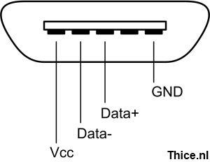

It's very common that USB port is charging fine but not with data connection or vice versa. You should try a new flex USB charging port as it's cheap, under $6, and easy to replace.
This is an example of a micro USB; if pin of data is damaged, your tablet is still be charged normally.
