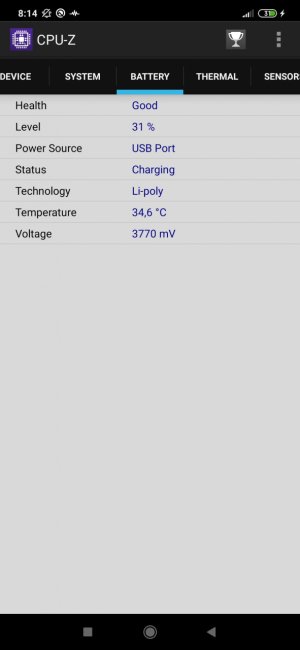

Check in CPU-Z app what the battery volts and temp at, can give some indication , and yes lower voltage or failing battery can cause issues on CPU . But these things only a real good repair shop can test .
Here is CPU-Z screenshot.
So, it's CPU or bad battery? Battery Drain start when i first time turn on phone. The same with Redmi 8A.
