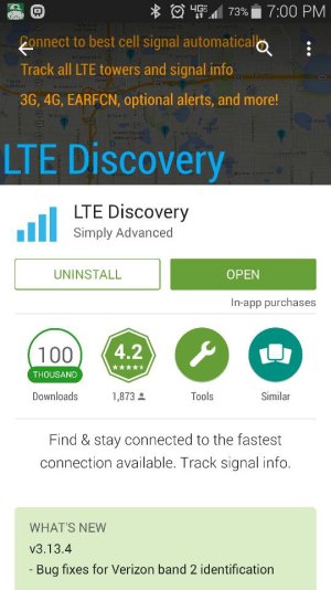

There's an app called lte discovery that will show what band you are on. XLTE is band 4
From the Google play store
As oraix said if it tells you that your on band 4 your on XLTE! Other way to tell is if your getting crazy fast speeds on Speedtest
