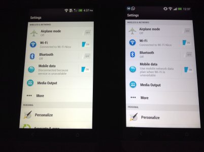

Hi I have an international version unlocked of the HTC One and was very happy with it, thing is I just bought a new one from my carrier in chile thing is:
Screen has like a yellow tint that the old one did not have I will post a picture where both are set in the maximum brightness. The problem is I send it to my carrier so they gave me a new one but it has the same issue. Is it that HTC is designing some of the one's with worse quality screens, I am pretty disappointed with this.

There are several different displays HTC used when manufacturing the One. Two are Samsung displays, one is Sharp, and I believe there was a fourth. The Samsung display in my One is awesome with no yellowish tint. You may have a device with another display.
Really? This would be really good, is there a way to know fast if it's the adhesive or just the screen? Thanks
Wow, I had no idea. Thanks for sharing that information, Rndomuser.
@nalbagli if there's nothing else wrong with your device (blurry camera, gap on the top, gap on the bottom, screen sticking out of the device a little, etc.) then I think you should just keep it and wait for the adhesive to dry up, as mentioned above; if it doesn't, then you'll have no other choice but to get it replaced. If the HTC service center is near you, you can pay them a visit and show them that picture and ask them about this - if they do have any information regarding that adhesive, I am sure they'll share it with you, however tell them that if it doesn't work you'll have to get it replaced as you may find it a bit annoying.
