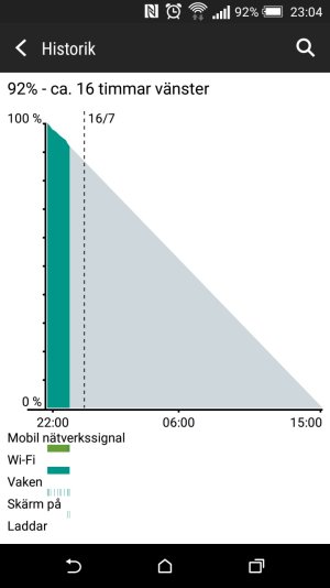

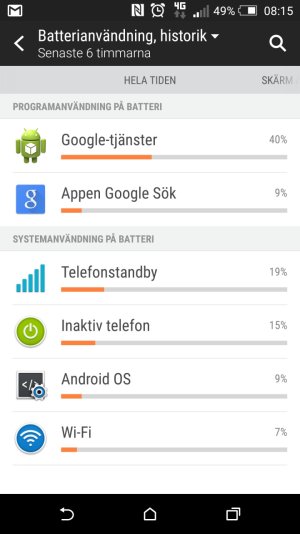

Got a brand new HTC One M8s (notice the s as in new edition of the old M8). It's supposed to have a great battery according to sources and acually, at times it has shown that as well. At one point last week-end, I got the phone to run over 50 hours with 2 days of "normal" use, and normal use with a new phone is more or less more than normal in any other case. Normal use is maybe a couple of hours of phone calls, 3-4 hours of music and podcasts etc. So with this result, I was very happy.

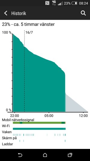

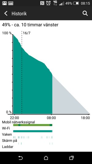

This is varying though. Mostly, like the last week for example, I get shat in the face by the battery life. Just for stats I did this last night: Unplugged it at 100% around 10 pm. Didn't use it at all, except setting an alarm. Battery was down to 85 % by 12 pm when I went to sleep. I wake up at 7:30 am with 50 % and I get to work (still not even using the phone) and at work I try to restart the phone to see if there are any crazy things in the background killing the battery. Restart at 44 %, when it starts anew, it's at 23 %. I mean, WHAT? So the battery has just gone from 100 % to 23 % in 10 hours with NO USE AT ALL?
Ofc, I have tried most things. Removed all the auto-syncs, installed greenify to kill the instagram app that I thought was the theif. I have updated to the last software version (whichever it might be) and been in general battery smart. I've done so many things, that is actually killing the functionality of the phone (like the sync, ofc a phone is supposed to be able to automatically sync the weather and mail so I don't have to check in manually???). After looking at the stats, I believe that the wake lock might partly be my bug, but it can't be the whole answer, because no other post I've seen about wake locks kills the phone this fast? Though, the flight-mode is actually a real battery saver, so it might be something that is shutting down at flight mode.
So look at the screen shots below:
Screenshot_2015-07-15-23-04-52.jpgScreenshot_2015-07-16-08-15-43.jpgScreenshot_2015-07-16-08-15-19.jpgScreenshot_2015-07-16-08-24-37.jpg

Looks like Google services is draining a large portion of your battery. Try disabling location services and see if you notice a difference.
I play with my food
That is one of the first things I did actually, hasn't been on for several weeks.
edit: and from what I've understood from other forums posts is that google services is actually more or less the OS itself?
I think power consumed by the OS is represented in the stats by both "Android System" & "Android OS". I am a little hazy on why there are the two different entries. My understanding is that the "Google Services" process encompasses items such as location reporting and all the syncing between your phone and Google's servers (ie calendar, contacts, books, etc.).

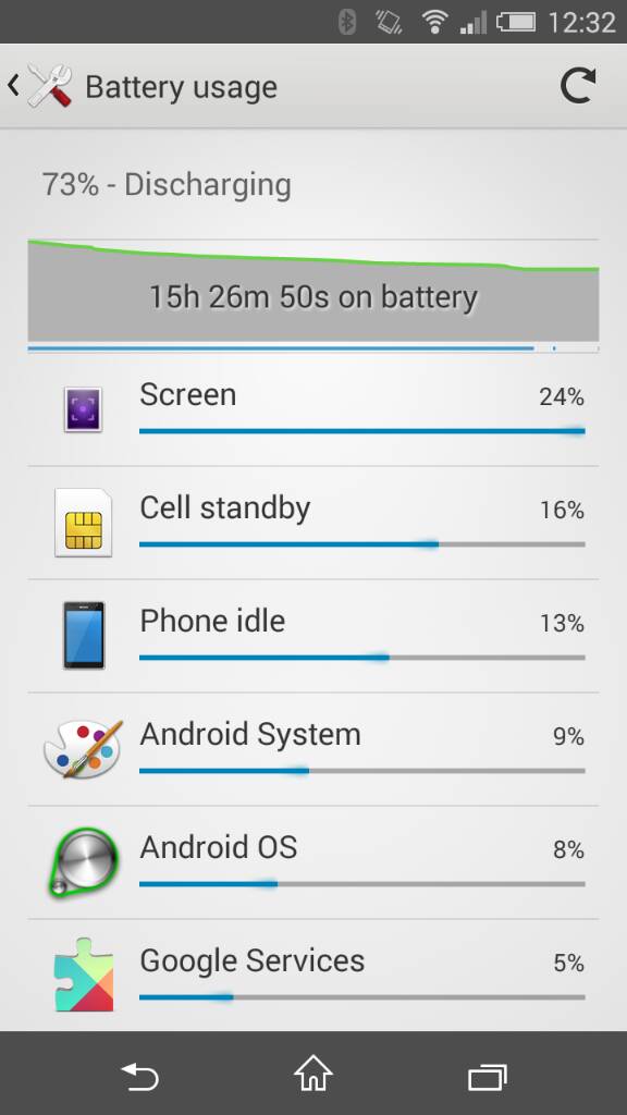

40% seems too high to me. For comparison, take a look at my stats. Now, this is from a Z3c running 4.4.4 so not directly analgous, however my "Google services" consumed only 5% after 15.5hrs of up time.
Have you checked the sync settings under your Google account to make sure there isnt some sort of sync error? Also, remember that you can always perform a factory reset if all else fails. Since the battery life was good at one point, a factory reset would probably get you back there.

40 % is far too high, considering that I've actually turned off almost all automatic sync items from that list, AND considering that 40 % of almost 80 % battery drain, is a lot for syncing ;) . I only have one inbox and one calendar left syncing (which is as I explained not the way it's supposed to be, I really do appreciate the fact that the phone syncs from time to time). And no, I cannot find any "errors", they all say last sync completed at blabla-time.
I'm having this problem too , turned off google now and search,downloaded Gsam to see what was draining my battery and it was also the android OS and android kernel.Did a factory reset as well as wiping cache partition, but still didn't work for me. considering to root this phone and slap it a new custom rom that might improve the battery life - HTC ONE M8s
Is this a once in a while issue, or do you get these results daily? If it's daily, have you checked your Wi-Fi and mobile signal strengths to see if the phone may be having trouble searching and locking onto the signals where you keep it overnight?
If it's a regular occurrence and one you've seen gradually get worse over time, it could simply be the battery losing capacity. This could be simply a defective/weak battery from the start, but charging habits can affect its life too.
A wakelock problem looks to be your best bet. Judging by your screen shot in post #1, your cell and wifi signals seem fine.
Have you tried using CPU Spy to verify that your phone is not spending the majority of its time in "deep sleep"? (Which it sure doesn't seem to be doing.) Have you uninstalled and re-installed any apps, especially Google apps, to make sure that they are all up to date?
And can you still return the phone as defective?

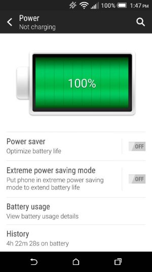

4 hours off charger on 3G. 4G is off since 4G is spotty near my job. Made a call, checked some text messages and of course pulled up my battery stats. Location/GPS off, auto sync off, vibration off, auto brightness off, screen brightness set at 35%, I never auto update apps, I'm also logged out of all apps such as Facebook. I don't use instagram twitter or snapchat. Like I said I only checked a couple text messages and made a phone call. I would periodically check my battery percentage by double tapping to wake the phone and I took a few screen shots of my battery status, I did all of this during the 4 hours and my battery still remained at 100%. I've had this phone for over a year.
Posted via My htc One M8

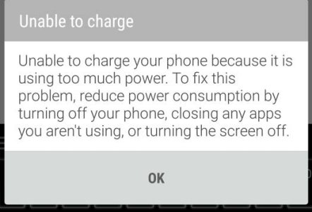

Hello I'm having an issue with my htc one m8. All of a sudden my phone started to die so fast. Than it started to die on the charger. Everytime I plug it in to charge my phone it doesn't charge or it drains on the charger. Everytime I touch the phone while it's on the charger it stop charging. And off the charger the phone dies so fast within 30 mins. And my phone also send a me a notafction saying this.... I did everytime possible j cleaned my phone, I restarted it,i took it to two sprint stores to help me fix this issue and both of them recommend me to a new phone. No one was a help i need help someone.. Thanks
The phone is using more power than it can draw from the charger (the design of the phone determines how much it can draw). Look in your battery stats to see what's drawing most of the power. If there's noting unusual, see if Ampere will run on the M8. If it does, see how much current the phone is using when it's not being charged, and how much current is charging it when it's plugged into the wall charger. The charging current should be higher than the using (discharging) current. If not, you could have a blown capacitor on the motherboard.
