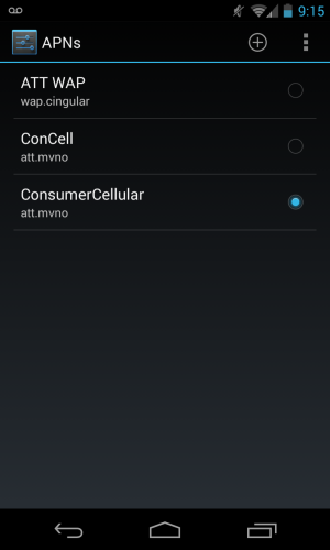

Just for future reference, you can create new APN configuration set and name & save the new config to differentiate from the old one.
Thank you hrsetrdr for your help. The APN settings worked for me on my new Nexus 4 with Consumer Cellular in Southern California. I also used the renaming option that you suggested to save the settings that CC Support provided to me, which were slightly different.
I also noted that I needed to press the three vertical dots for the Setting menu in order to find the 'Save' function. Once I saved the new configuration, the radio buttons showed up so I could select the new APN configuration settings that I wanted to use.
