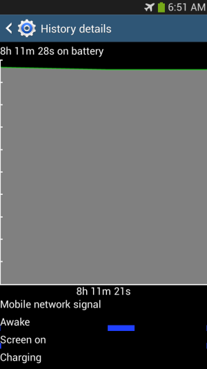

Good. But, do they stay stop'd? I have to stop a bunch of Google services every night, because these become dis-services while I'm sleeping. For example, Nearby Service does not need to be looking around for any near field communication overnight. I don't even want it using resources in the daytime either! Unfortunately, some of the apps I luv and use regularly have features that cause stop'd services to start running. Worse, nearly every time I go to the Play Store, the next morning my battery will probably show about 20 to 25% drain'd overnight. A re-start has help'd some times, and eventually my S4 Mini is back to normal, with only 2% overnight drop. Like this:
Battery was at 97% when shutting down for the night, and at 95% first thing next morning. For unknown reason, the processor was awake for almost an hour in the middle of the night. But it didn't tax the battery THIS time. You get to this graph via:
Settings > More > Battery
And then, tap on that graph's gray area to get to this next graph.

2% overnight drop in a flight mode = unbelivable :)), flight mode in my device doesn't help me, it discharges ~30% of battery for 8-9 hours.

Outch! Awfully steep and steady drop. The quick triple drop located midway is understandable because of the corresponding 3 short time intervals of screen on also midway. That last 'screen on' would maybe your alarm, I suppose. But why should there be 3 awake periods before the alarm, and 2 more after? Most troublesome is that the graph never levels out, indicating SOMEthing is causing a continuous battery power leak.
BTW thanks for the link to Android Assistant, major bag of tricks and only 99¢ for pro version. I've been using Greenify to 'hibernate' stubborn apps that otherwise keep starting themselves in the background, and then causing some of the Google (dis)services I had stop'd to start running again. Another app I've tried (but not gotten anything useful from) is Wakelock Detector. It can give some clues, but the info often contradicts Android's own battery stats info.
The screen on graph it's ok, I turned on at flight mode to check some details and the last "screen on" it's alaram you're right. I cann't understand what does "awake" mean.
