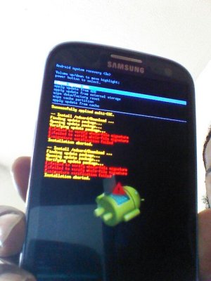

I keep getting this failed to verify

Hollywood, which file did you download? Did you try downloading it a second time, in case the first one was corrupted? And which set of instructions (Post #1 or #2) are you following?
I downloaded the first instructions.... Didnt work first couple times....so I downloaded zip again still getting error....
