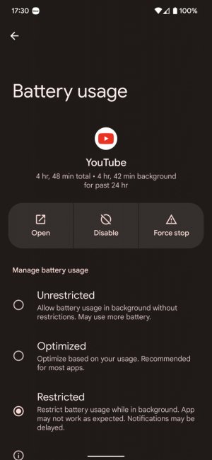

Title says it all really. Have YouTube set to restricted in battery settings but it still runs, in the last 24 hours it has run for 8 hours in the backgrouns and is the biggest batterty user.

It is in battery usage stats, was hoping the February update might have fixed it but alas not!Screenshot_20220210-173046.jpg

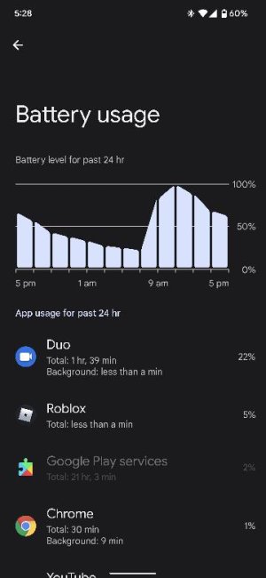

It is in battery usage stats, was hoping the February update might have fixed it but alas not!View attachment 341282
This what i was looking for if its top on list in my screenshot , but thats still not a good indicator because if you just charge battery up and go into YouTube for 20 minutes guess what going be high on the list , yes youtube , u would need something like accubattery to diagnose this further the stock one not enough.
Yes but it shows 4:42 of background activity out of the total 4:48
Are you watching any embedded YouTube videos in other apps or browsers?
I don’t recall using it at all actually letalone almost 5 hours. I guess embedded could explain it.
Yeah, maybe if it's an embedded video in an app or browser, it's inappropriately staying active if that app hasn't been closed out of RAM.
