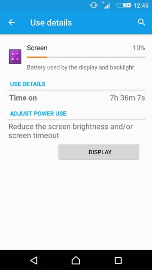

I had that stright after lollipop but I several resets just to be sure the encryption wasnt turned on as some phones have it on as default after lollipop i think. After i did about 3 continuing resets its works great now i average about 7h screen on time sometimes more sometimes less just depends what day im having with my phone... Another thing worth mentioning my partner has the z3 and with stamina on it seems to drain battery quicker dont know why but it dose so u could try without stamina.. If all else fails connect it to pc companion and do a full repair

Thats strage I got the 5.1 ota then did a factory reset and reloaded my apps & games and my battery seems to be ok
