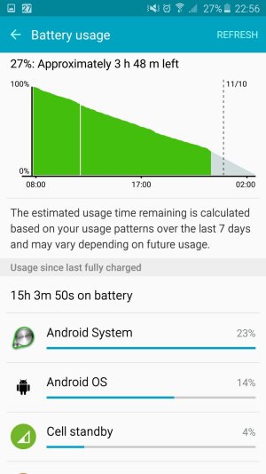

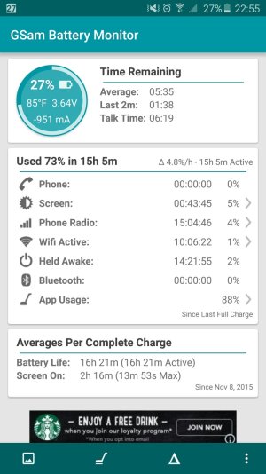

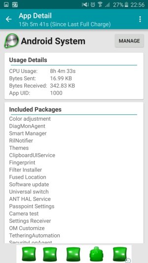

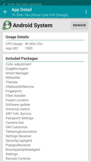

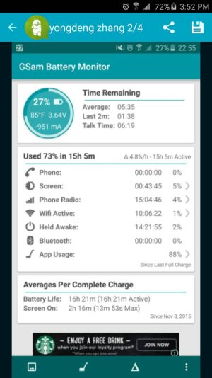

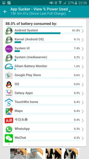

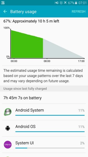

Here I attach some screen shots so that you know what I am talking about. I had a whole day meeting and barely used the phone. You can see 88% of the battery is consumed by apps and over 70% is used by Android System/OS. Look at the CPU Usage, you see Android System is running for over 8 hours. It seems something is keeping the Android System awake for the whole time but I just don't know which one. I tried to disable all the apps belong to Android System but failed. Always some apps that you are not allowed to be disables.

Well because you have a very low signal and a low signal will drain your battery. Your phone radio was on for 15 hours.

Going by this.. Your phone radio was on the entire time though.

With Android System and Android OS it is hard to diagnose that. Those are just "buckets" that a lot is dumped into.
It would be interesting to see these graphs when you have a good signal. A bad signal will drain your phone similar to this. To have airplane mode on and then turn back on WiFi when at home, that will give a better idea where your signal is bad.

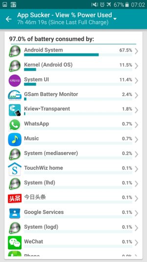

I apologize for the graphs. They are kind of misleading. I think my exact problem is: turn off WiFi, turn on airplane mode, even turn on power saving mode, the battery drops over 23% within 7 hours. The same situation, my previous phone, LG G pro2, drops less than 5%.

Have you tried to run it in safe mode to see if it drops that much?
It is almost impossible these days to figure out when it is in Android System or Android OS without root.
Now you can install Wake Lock Detector from the Play Store and it has instructions to install things on your computer and hook your phone up to the computer and you can tell more that way, without root.

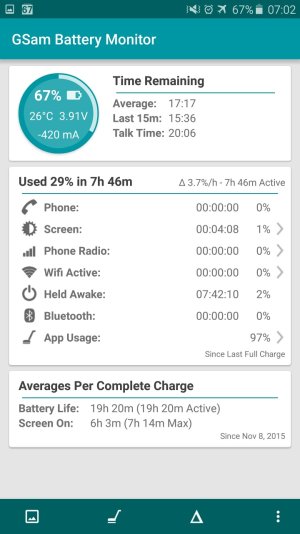

Here are the new graphs which show my real problem. Airplane mode, no WiFi, battery drops by 29% in less than 8 hours.
Screenshot_2015-11-11-07-01-32.jpgScreenshot_2015-11-11-07-02-31.jpgScreenshot_2015-11-11-07-02-40.jpgScreenshot_2015-11-11-07-09-39.jpg

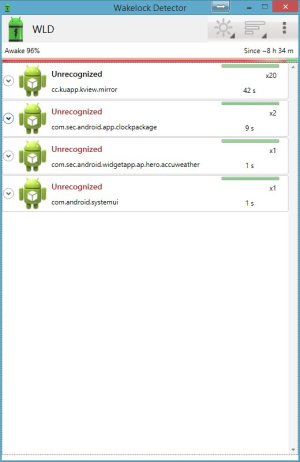

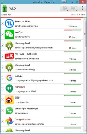

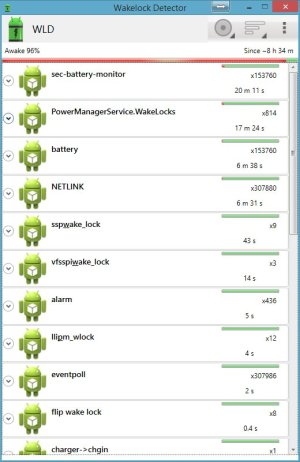

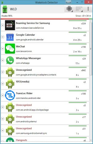

I installed PC version of Wake Lock Detector and here are the graphs. What are 'sec-battery-monitor', 'battery', 'NETLINK', 'eventpoll'? Why do they wake up thousands of times?

Re: Android System battery drain in Note 5 when stand by (Not fixed so far)
Ok, I'm going to get someone to come look that knows a bit more about WLD stats.
Thanks. I double checked. The problem seems to be related to these: sec-battery-monitor, PowerManagerService.WakeLocks, NETLINK, eventpoll.
