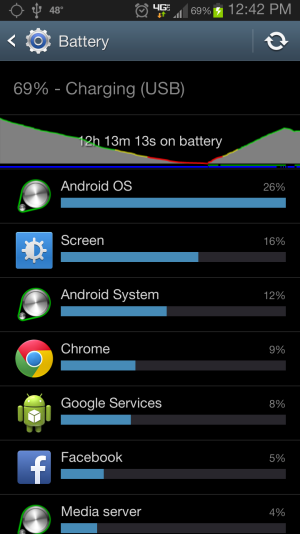

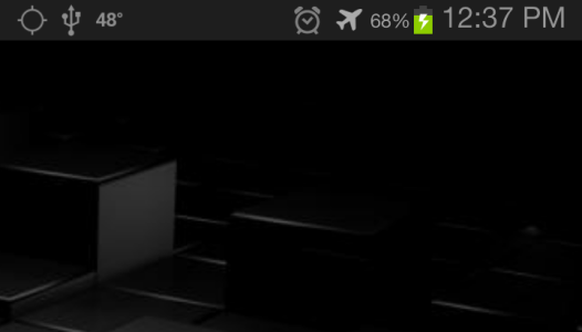

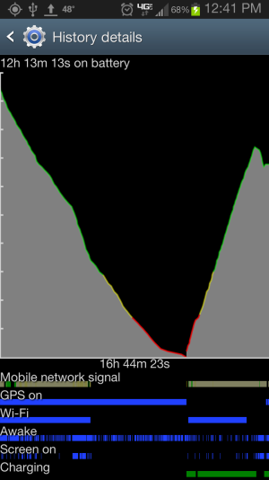

So I usually put my phone in Airplane Mode before bed (so the alarm goes off) and recently noticed the battery will drain completely still. I've also noticed my battery seems to drain pretty quick all the sudden. I think I've narrowed it down to GPS being active constantly (the icon in the Notification Tray always blinks). It even stays on when the phone is in Airplane Mode. I have no idea what app is keeping it on. Is there a way to tell? I disabled location sharing in everything I could think of. What else can I check? I attached some screenshots of the battery usage.

For the OP, airplane mode only affects the radios, and does nothing about running programs, background processes, or anything else. Looking at your screen shots, you have a lot of wakelocks. Something(s) is/are running in the backgound, keeping the phone awake. Check out Better Battery Stats or Wakelock detector to try to igure out what.
It also looks like your GPS was on and trying to communicate even during airplane mode. What location-based apps or services are you using?

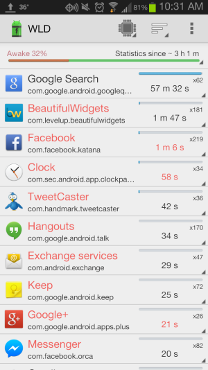

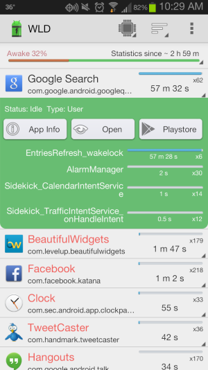

Is that normal for Google Search???

No. I'm at work now, but I'll take a closer look at this later, In the meantime, look at your Google now settings and see what sort of notifications you have set. Especially location based ones.
Commute sharing, Location reporting and Location history are all off in Google Now
