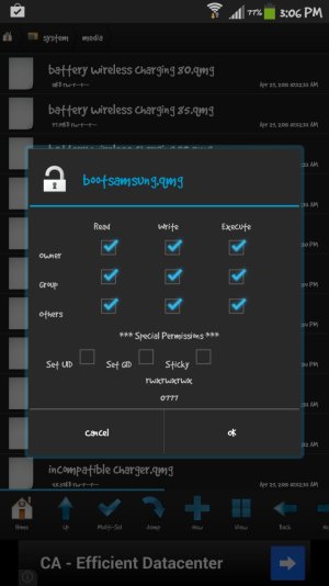

Is this how it is supposed to look? I have no what I am doing :-! to be honest haha. With the current permissions, it still does not show the boot animation. Should I check and of the last three? I don't know what they do but I'm not risking bricking my phone if that's what it's going to do lol. 2014-01-30 20.06.19.jpg.
The bootsamsungloop.qmg is also has the same permissions as the attached image.

No. See all those permission behind your pop-up, it needs to match those. Detick all of the executes and group/write and others/write. Set permissions and reboot.

Oh okay I see what you mean. After doing that however, no luck. I know it's not necessary to actually have a boot animation but it bugs me that I have no idea why it is not working. Any other ideas? Thanks by the way!
